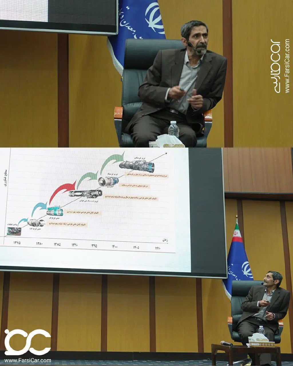

Not sure if this was posted before but this is from a conference back in august showing the development cycle of a future Iranian heavy turbofan. not sure if it's just a placeholder but it's shown to be an AL-31 analogue or copy. Maybe Maduro came in clutch and gave Iran one of Venezuela's Su-30 spares? Or TOT from Russia after drone deal?
Has been posted. It’s a placeholder image. Iran is alluding to an AL-31 class engine in development.
I have seen the plans of Iran's projects in developing the turbofan engine
They say they got to build a small turbojet engine, AWJ, and a small turbofan engine, JAHESH, but these two types only made one model.
What is the problem with access to a production line?
