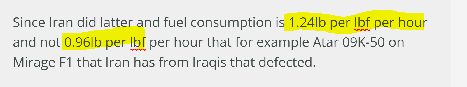

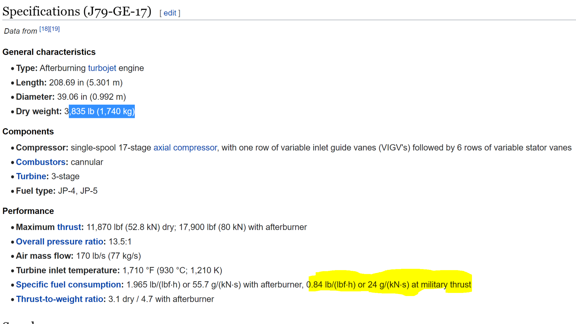

1. Are you actually try to correct me and make an arrangement in favor of the J85 by stating that it's fuel consumption is even worse than the figures I gave?
You do understand that 1.24lb of fuel per lbf per hour is more than 0.96lb per lbf/hr.
Are you trying to make my argument for me or do you not understand fuel consumption?
Less fuel better! Not more!
2.My argument was about moving on to the J79 as appose the J85 & not about any other engine! Or Iran's technological capabilities and in fact I clearly state that the J85 is below Iran capabilities and that's why we should move on! So what exactly does the Jahesh 700 have to do with anything. It's an Iranian version of a completely different engine and if anything it proves my point! It's time to move on!
3. Thrust per weight! really?
1st off the vast amount of thrust and air flow you achieve is far more useful on a military aircraft and that negates any negative impact of a heavier engine with higher thrust to weight ratio. And if you want prof just compare the military capabilities of the F-5 vs F-4! It's not even a contest! In terms of thrust to weight a micro jet engine could have a better thrust to weight ratio that doesn't make it a suitable engine for a fighter jet!
These are fighter jet engines not cruise missiles or jet powered gliders!
Also in terms of thrust to weight I clearly mentioned that the J79 are big bulky engines that leave a lot of room for upgrade and weight reduction and that makes it far more suited for upgrades then J85
So for R&D and working on improvements the J79 or better yet the Al-21 are far more suited for the task.

1. Except I have not stated fuel consumption of J79 as I clearly stated it being about J85 not J79 as you assert.

1. Your making an argument for the J85 and against the J79 by stating the it's fuel consumption is even worse than the figures I gave. Plus, I'm pretty sure your own figures are incorrect. Your figures are for full thrust an not max military thrust.
2. To physically work on and build components for any engine that's smaller is both cheaper and easier. However, larger engines like the J79 have more room for upgrades which means it is easer to get an increase in performance by working to upgrade a J79 than it is for smaller diameter engines like the J85.
Which means changing the design of your compressor, changing the design and materials of your composition chambers, upgrading your fuel injectors, upgrading your ball brings, changing the design and materials of your turbines and engine casing,..... these improvement make the increase in performance worth the expense and that's what makes upgrading the J79 easier. And that has nothing to do with the fact that it's physically easier and cheaper to upgrade a smaller engine!!!!!!
3.Again with Thrust to Weight! Trust to weight only matters if the engines have similar thrust and similar fuel consumption and performance that's when you can compare the thrust to weight ratio of two engines and say one is better than the other.
The thrust to weight ratio of an engine doesn't much matter when that engine requires more than 20% more fuel per pound of thrust then a heavier more sophisticated engine. (Or an engine that has tbo of 5hrs vs 1000hrs,......)
Like I said a micro jet engine could have a better thrust to weight ratio than a AL-31 that doesn't make it better!
What is incorrect is your lying about what I have stated and at that you have doubled down by lying about what I have stated.
Anyone can read what I wrote and see that you are lying about what I wrote by simply looking at what I have written in this forum.

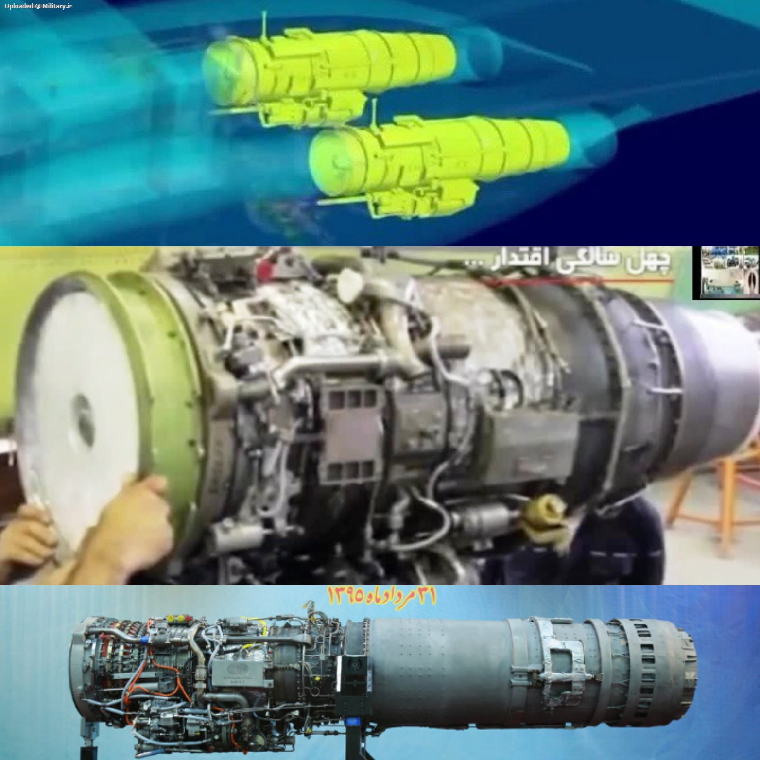

What does Yasin fly on ? It looks very different from OWJ J-90
@Hack-Hook
@Hack-Hook
that engine certainly look a little different . but consider it that it has no afterburner while the owj shown come with its afterburner .
what i heard is that yasin uses not afterburning version of owj
the engine shown here maybe is some modification of owj, they certainly look a lot to each other , but different to some details sadly the engine is not turbofan
