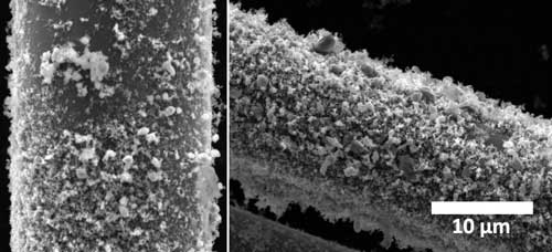

A silicon carbide fiber enhanced with a carpet of 'fuzzy' carbide nanotubes created at Rice University is shown at left. The same fiber with fuzz intact appears at right after researchers burned it with a lighter. (Image: Ajayan Research Group/Rice University) (click on image to enlarge)

Tests to see how well the fibers handled heat showed plain carbon nanotubes burning away from the fibers, but the silicon carbide nanotubes easily resisted temperatures of up to 1,000 C.
