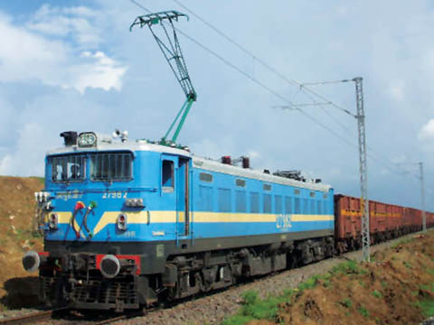

However on WDFC, this will the first time that Double Stack container trains will be used under OHE wires. About 2 years back, IR conducted a trial with two Vizag based WAG 7 locos with high reach pantographs for this purpose successfully.
I didn't knew about this. So for double stack container movement we have 7.8m high OHE ,any report on how high would it be for triple stacked container movement on DFC's ,which would be run on some routes,as per reports.
