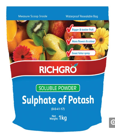

I have experimented myself and have confirmed it. Try it next time, when the plants reach flowering stage start giving them Sulphate Of Potash and see the difference. I used
dissolved it in water and gave it to my eggplants and okras every week during the fruiting period. The plants went crazy and i got a lot more fruit, which were also comparably larger and noticeably tastier.
https://www.bunnings.com.au/richgro-1kg-soluble-powder-sulphate-of-potash_p2980321
I have experimented myself and have confirmed it. Try it next time, when the plants reach flowering stage start giving them Sulphate Of Potash and see the difference. I used View attachment 565837 dissolved it in water and gave it to my eggplants and okras every week during the fruiting period. The plants went crazy and i got a lot more fruit, which were also comparably larger and noticeably tastier.

yes and no, I sometimes use it on raspberries if they become deficient in magnesium
Epsom Salt Myths in The Garden https://www.gardenmyths.com/epsom-salt-for-plants/
instead of potash, I sometimes buy tomato fertilizer (high in potash)
and my garden and greenhouses are designed like a food forest so more or less they feed themselves
