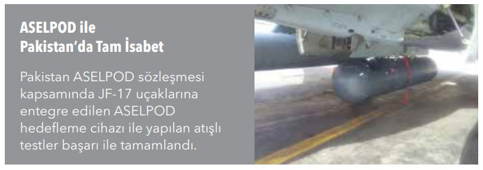

Aselpod on Jf17 spotted
So the goodies have started adding into the jets arsenal.
local Turkish press reports about the new order of Aselpod .... but name of country is not mention in that report
http://www.defenceturk.net/aselsandan-aselpod-ihracati
It state new integration and paf has already integrated it on jf unless this is for paf f-16s ??
Paf had 24-32 aelpods on order between 2 separate order in 2106 and 17
That country could be "Azerbaijan"
Pakistan placed two similar orders of 8 pods in each order. Now if any new I don't know
It’s was 8 pods plus integration for about 24 million and second order was claimed to be for 16 pods for ~25 million so total 24
I think depending on the jf fleet size 1/4 - 1/3 number of pods will be required
Aselpod has successfully completed weapons targeting trials on JF-17 in June, 2017.
Are there more clear pics available ??
Per initial news available pac was responsible for developing the pylons i.e alternate mission equipment
this is center station and may be another version for new under intake station on block 3 ?? And future upgrade on older blocks
Expect about 40-50 pods for jf fleet may be more
Latest variant L-15 B for ground attack has now more stations expect block iii Jf to follow same pattern for total of 10-11 stations, 2 new under wing plus one or two under intake, same 9.48 meters wing span for both jf and L15
