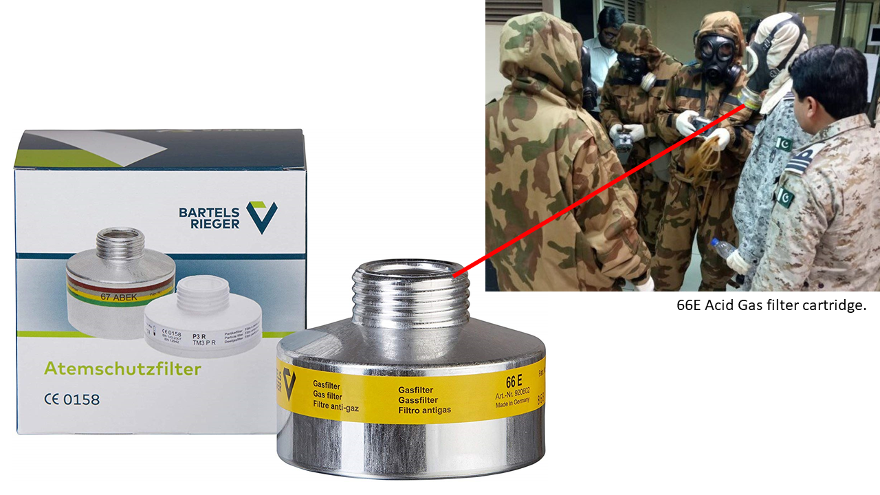

3. Please refer to this photo:

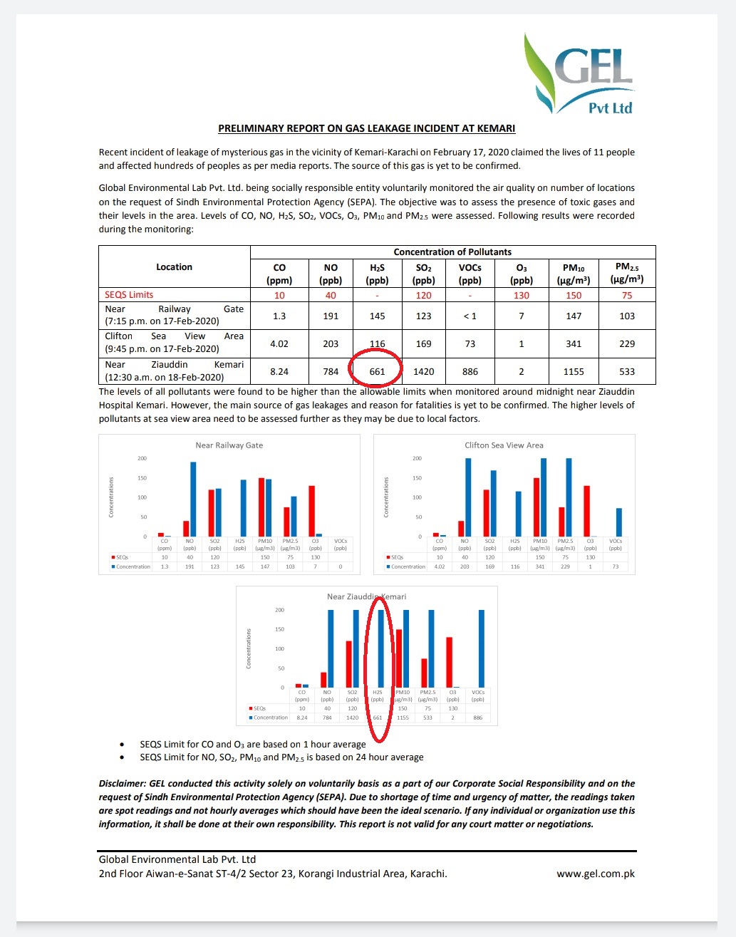

The photo above shows respirators with 66E/EN141 rated filters for "Acid gas". Whilst the unloading of soybeans may have cast dust into the area the large area around the port and the mention of "rotten egg" smell points to a particular gas used in fumigation and a byproduct of mishandling of oil products: H2S: Hydrogen Sulphide
Please refer to this report:
How dangerous is H2S:

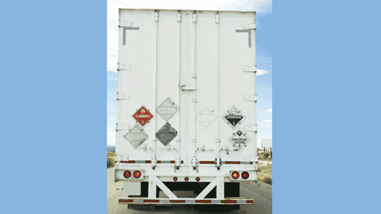

A sample container with Warning diamonds which warn handlers about the contents for example, this container has contents that are highly flammable, corrosive and post a serious inhalation risk.
