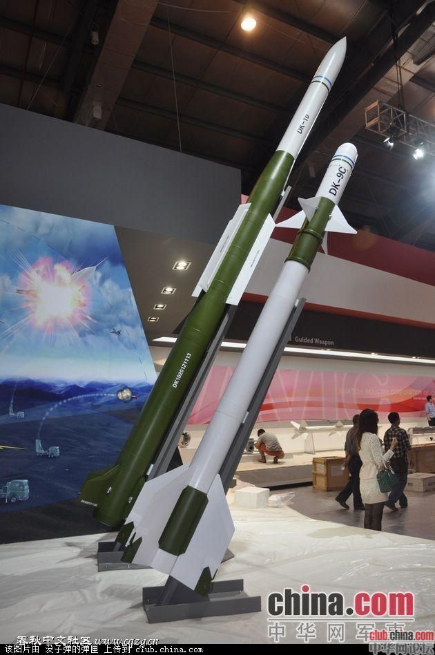

China DK-10 missile prototype:

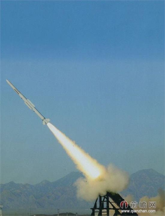

2013 DK-10A missile launch test:

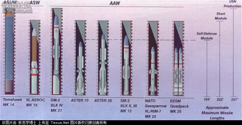

4x ESSM missiles can install in one VLS
@Luftwaffe
It has longer range, cold launch VLS and SD-10A has its own guidence system. Its much more advanced the HQ7 systems. This can also be the answer for defending our machanized infantry.
It can be a solution for our F-22P sized frigates?
@Penguin
Sure, provided it can be quadpacked into a single 8 cell VLU that can fit F22P (note: Mk41 comes in different length as well as single cell option. The shortest, tactical, vlu could well fit F22, it is also to be used on Turkish mod-ADA (Milgem) corvette. Not sure if this would apply also currently available Chinese vlu's). Russians offer similar solution using R-77.

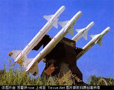

The Sky Dragon air-defence system using SD-10A missile (Export version PL-12 missile), DK-10A also developed from PL-12 but missile body longer than SD-10A, update version further range. PLAN chose DK-10A missile as China ESSM project.
China Sky Dragon using SD-10A:

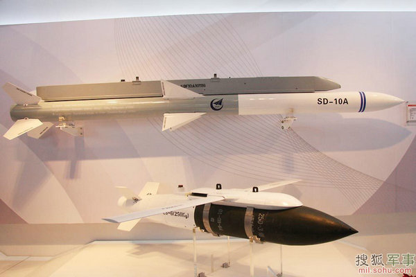

SD-10A missile (SD-10A fire range 20-30km):

Can anyone tell me what the DK-9C variant is? And are these surface to air missiles?
The DK-9 missile developed from PLAAF‘s PL-9D short range air-to-air missile. Yes DK-9 is land based air-defence missle (short range).
