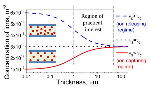

Figure 1. The dependence of the concentration of mobile ions in the cell filled with pristine liquid crystals on the thickness of the cell. The ionic purity of substrates is quantified by means of the dimensionless contamination factor vS. (Image: Dr. Yuriy Garbovskiy, University of Colorado, Colorado Springs)
"In general, we should consider interactions of ions in liquid crystals with both substrates and nanoparticles," says Garbovskiy. "To understand how substrates of the cell can affect the concentration of mobile ions in liquid crystals consider pristine (no nanoparticles are added) liquid crystals. Mobile ions in liquid crystals can stick to the surface of the substrates (the adsorption process)."
As a result, this process leads to the reduction in the concentration of mobile ions as shown in Figure 1 (solid curve). As can be seen from this, the magnitude of this effect depends on the cell thickness. It is very pronounced if relatively thin cells are used and becomes negligibly small in the case of relatively thick cells. The reduction in the concentration of mobile ions can always be observed if 100% substrates are used.
However, the use of contaminated substrates can result in three different regimes, namely, the ion capturing regime (Figure 1, solid curve), the ion releasing regime (Figure 1, dashed curve), and no change in the concentration of mobile ions (Figure 1, dotted curve).

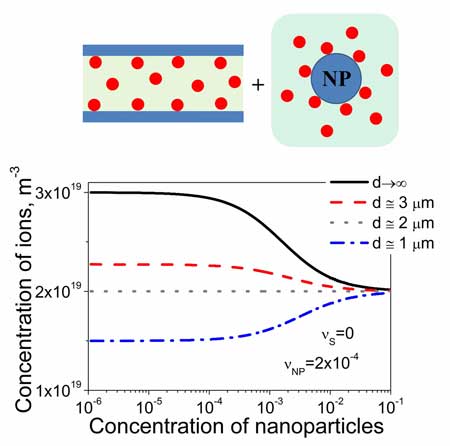

Figure 2. The dependence of the concentration of mobile ions in the cell filled with liquid crystal nanocolloids (liquid crystals doped with nanoparticles) on the weight concentration of nanoparticles calculated at several values of the cell thickness, d. Nanoparticles are contaminated with ions (the contamination factor vNP=0.0002) and the substrates are 100% pure (the contamination factor vS=0). (Image: Dr. Yuriy Garbovskiy, University of Colorado, Colorado Springs)
As can be seen from Figure 2, depending on the cell thickness, different types of the behavior can be observed. Garbovskiy's recent paper in APL provides a detailed discussion of scenarios which can be achieved if the combined effect of substrates and nanoparticles is taking into account.
All these effects are very sensitive to the ionic purity of both nanoparticles and substrates of the liquid crystal cell.
These results have important practical implications. Figures 1 and 2 indicate that the electrical properties of liquid crystals and liquid crystal nanocolloids depend on the thickness of the cell. Moreover, this dependence is a strong function of the ionic purity of both nanoparticles and substrates of the cell.
