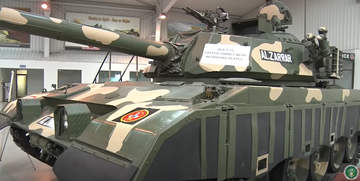

Another thing to correct about that Quora article would be that Al-Zarrar uses a western FCS and GCS
(THETIS from SAGEM of France) and not a Chinese one, the Durjoy uses a Chinese FCS, though I can’t say for certain which one would be better or worst, they have similar optics; 2nd generation thermals for gunner (the French thermal itself may however be better than the Chinese one)
The Type 59G BD and AZ are nearly identical in many fields (which makes sense considering their origins)
The only difference is that the Western parts in AZ are replaced with equivalent Chinese parts in the Durjoy.
The Durjoy has significantly better ERA coverage, especially the later ones, however it uses Chinese FY2 while AZ uses Pakistani AORAK (the latter supposedly being the better ERA).
The mobility would be about the same given they have the same powertrains.
The FCS/GCS systems as I discussed above are different but probably comparable in performance, AZ has the advantage of having better ammo (PA still uses the 125-I and Naiza DU both with AZ)
Otherwise firepower is the same, Durjoy should be able to fire newer ammo (like 125-II APFSDS) too, but I can’t say for certain if BD has Bought it.
All in all, very comparable tanks, the difference comes down to what the armies have added or removed from them (ERA, Ammo etc)

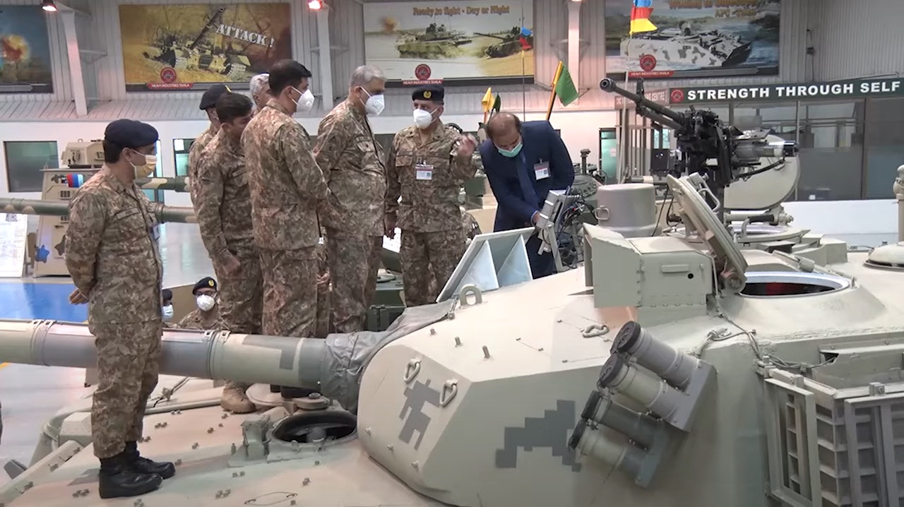

That is I believe based on M109 chassis?
I'd be interested in the turret specs and detail if/when available.
Likely Talha (M113) chassis with a more powerful engine and all around armor increase.

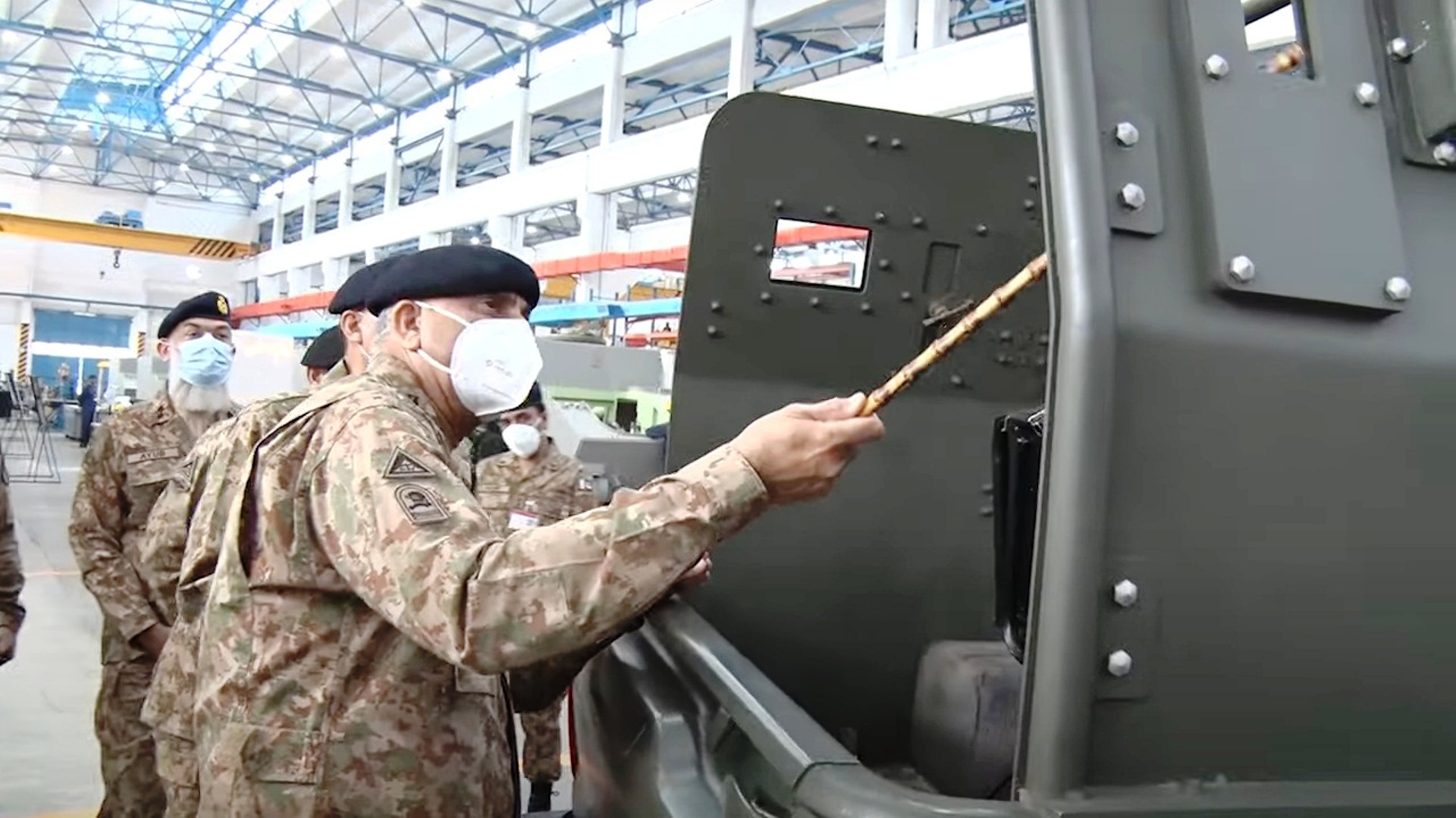

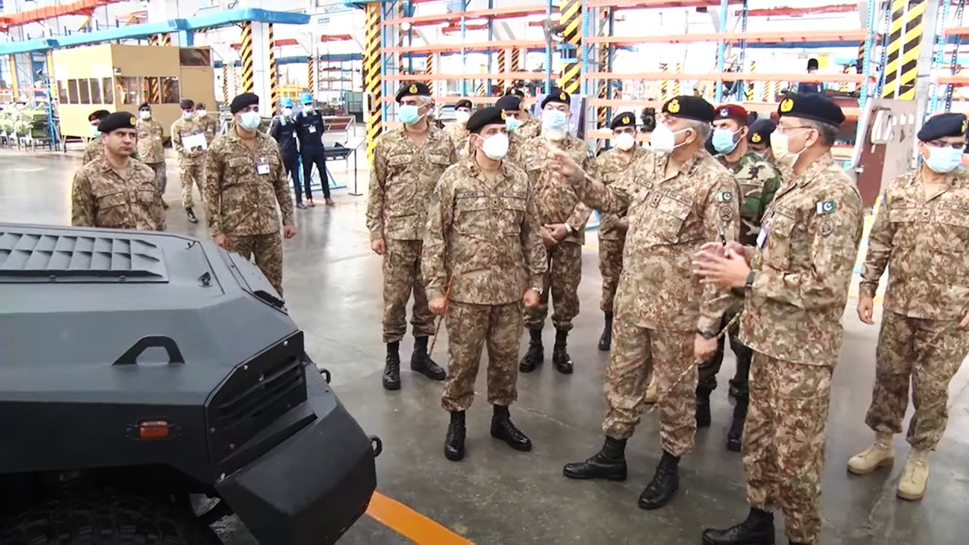

You haven’t commented the armour upgrade for the pick up truck.
They seem to be in army paint, but I recall a contract like this being put forward by FC, so these could be going to either force, its not going to make the vehicle safe from IEDs, but it’s certainly a start.

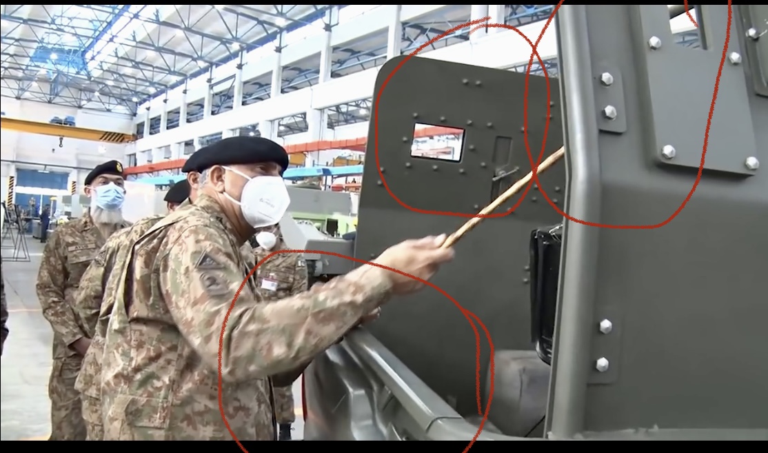

the issue I have is that apart from the certain regions which are noticeably armored, the rest of the steel seems very thin, To stop the a bullet fired from an average rifle in the hands of a terrorist (AK) they’d need level 3 equivalent plates, thats a quarter inch thick hardened steel. Given how this steel has a bend in it and seems much thinner on most areas of the side panels, I doubt it’s actually bulletproof (May just be due to the angle of the photo).
it would be a lot more useful if the entire thing was armored, maybe the logic behind this is that it’ll protect where the head and neck go and the parts below that are covered by the soldiers own body armor, but that’s such a stupid thing to skimp on given how many soldiers we’ve been losing due to these unarmored vehicles.
I hope they know what they’re doing with this and aren’t playing with the lives of Jawans again. It also annoys me because HIT actually does offer conversions for commercial vehicles like Defenders, Hiluxs and other trucks to make them fully bulletproof and grenade resistant, and those are actually done well. The army (or in this case the MOI) could easily buy a few to deploy in the hot areas.
What we need is a V shaped Hull to protect these tin cans against IEDs
Not these side armor plates

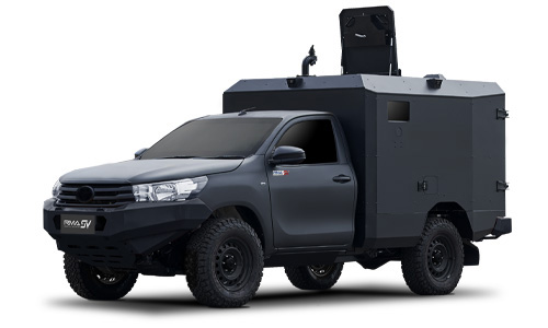

On the loading place, can be build up a V-shaped armoured hull compartment.

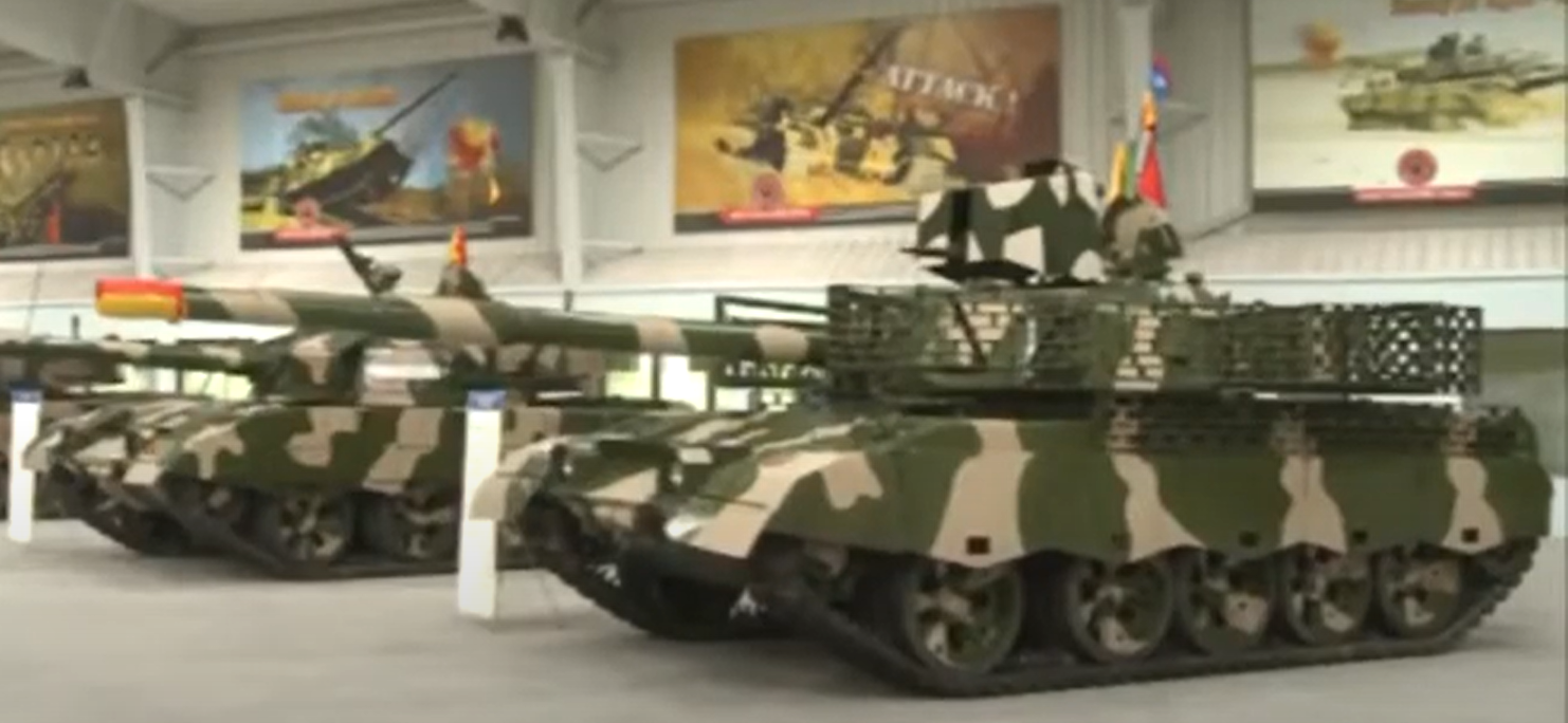

In this picture of AZ it has been modified with Slat armor around the turret probably for urban combat to protect it from HEAT rounds.Most likely after the incident?
I’m not sure when these AZs appeared but they were definitely used in combat in 2009, there were also plenty of APCs with all around slat armor.
On the loading place, can be build up a V-shaped armoured hull compartment.View attachment 792750
Alot of other quite good options by the same company that offers this as well ( South african RMA ) which i like alot ,

Any how people forgot that its not the duty of HIT to make a new Light armored vehicle from scratch , HIT is a factory that mass produces equipment not a R&D facility for Counter insurgency vehicles , a private company makes a design , its gets tested by HIT , if it fits the standards it gets mass produced at HIT , that is it ,
but like people on this forum keep doing their " wHy do HiT uNclEs noT mAkE neW MrAp "
Interceptor got offered by cavalier group , was tested by HIT and entered mass production , same with STREIT cougar , Mohafiz 2 and Mohafiz 3 , all were designs offered by private companies that HIT mass produced ,
