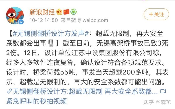

I heard that truck that caused the accident exceeded the limit of more than 100 tons
(Edit: actually it's more than 200 tons, and the limited load of the bridge is 55 tons.)

180 tons without truck weight. I assume 200 tons with truck weight included. It's mid size truck, unimaginable overloaded. Huge pressure. Out of the design of the bridge.
