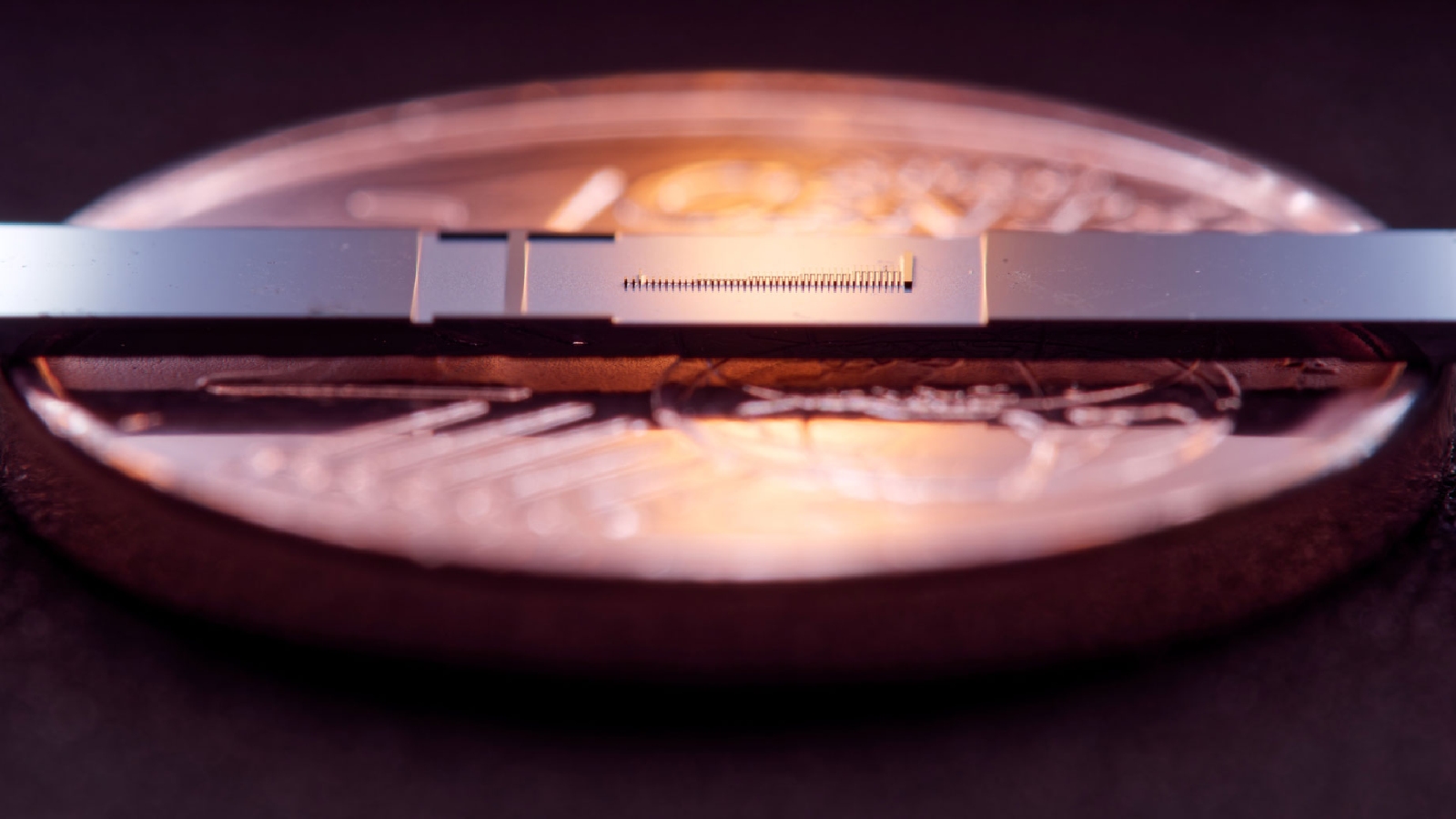

The device is small enough to fit on a coin.
a small, thin silver column sits on the face of a dime.
The nanophotonic electron accelerator consists of a microchip that houses a tiny acceleration tube that is just millimeters long. This photo shows the device compared to a dime. (Image credit: FAU/Laser Physics, Stefanie Kraus, Julian Litzel)
Scientists recently fired up the world's smallest particle accelerator for the first time. The tiny technological triumph, which is around the size of a small coin, could open the door to a wide range of applications, including using the teensy particle accelerators inside human patients.
The new machine, known as a nanophotonic electron accelerator (NEA), consists of a small microchip that houses an even smaller vacuum tube made up of thousands of individual "pillars." Researchers can accelerate electrons by firing mini laser beams at these pillars.
