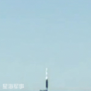

The HQ-26 is allegedly close to 9 meters based on pixel measurements of the GIFs below:
The 3.3 m variant is likely for the CY-5 (Yu-8) ASROC.
The 7 m variant (used on 052D?) will house the CJ-10, YJ-18, HQ-9, HQ-16, DK-10A/SD-10, and CY-5.
The 9 m variant (on 055?) will house everything the 052D does but in addition to the HQ-26 (see below).
Looks like a new missile, i don't know :angel: that's cold-VLS launch.
Just hear, China version "SM-3" or "SM-6" launch out ~! Both look same ?:blah::rofl:
