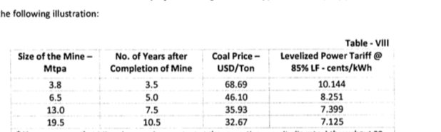

Is it not true that the cost of Thar coal is just above $60/Ton already?
Already explained in the document I shared. It’s part of the scaling process and will come down to mid 40s with the phase II expansion already going on and then to 30s range:
Yes, but that 2014 document was ceased by NEPRA in 2017. That estimate for scaling may no longer hold true.
The approved price per ton for the expanded mine is actually lower than that at $40.66:
Expansion at the above tariff on going and to be competed by next year:
That is the approved price, but the actual costs may be different. Your own link contains many caveats if you have read it.
