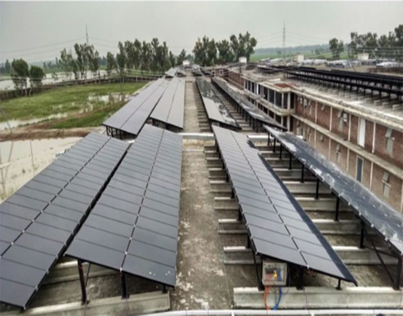

1.4 MW Rooftop Solar at Nishat Emporium
  • Client.............................:Nishat Emporium
  • Location.........................:Lahore
  • Installation Type.............:Rooftop
  • Total Capacity.................:1.4MW
  • Grid Connectivity............:Grid-Tied
700
KW Solar Solution at Supreme Feed Farms
  • Client........................:Supreme Feed Farms
  • Location.....................:Sheikhupura
  • Installation Type..........:Rooftop
  • Total Capacity.............:700KW
  • Grid Connectivity.........:Yes
