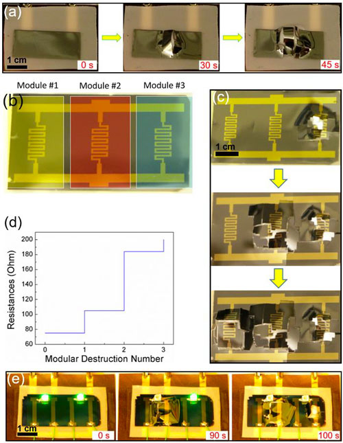

The researchers showed that joule heating effect induced thermal expansion and stress gradient between thermally expandable advanced polymeric material and flexible bulk mono-crystalline silicon (100) can be employed to destroy high performance solid state electronics as needed and in under 10 seconds.

"This motivated us to work towards developing a destructible electronics system that is compatible with current state-of the-art high performance CMOS chips and can revolutionize today's highly secure military applications that may need to self-destruct on command within seconds," note Abdurrahman Gumus and Arsalan Alam, who co-first authored the paper. "Moreover, instead of a complete destruction of all electronics, we were also interested in on-demand only partial destruction, for example, only the memory areas of the laptop to prevent any data theft."
a) Destruction of a single silicon chip on demand. b-d) Demonstration of modular destruction of a chip. Resistors were destructed sequentially on demand. e) Another demonstration of modular destruction. Selective destruction of electrical connections caused to turn off the LEDs independently. (Reprinted with permission by Wiley-VCH Verlag) (click on image to enlarge)
