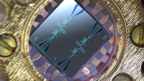

Photo of the centimeter-sized silicon chip, which has two parallel superconducting oscillators and the quantum-circuit refrigerators connected to them. (Image: Kuan Yen Tan)

The nanoscale refrigerator developed by the research group at Aalto University solves a massive challenge: with its help, most electrical quantum devices can be initialized quickly. The devices thus become more powerful and reliable.
“I have worked on this gadget for five years and it finally works!” rejoices Kuan Yen Tan, who works as a postdoctoral researcher in Möttönen’s group.
Tan cooled down a qubit-like superconducting resonator utilizing the tunneling of single electrons through a two-nanometer-thick insulator. He gave the electrons slightly too little energy from an external voltage source than what is needed for direct tunneling. Therefore, the electron captures the missing energy required for tunneling from the nearby quantum device, and hence the device loses energy and cools down. The cooling can be switched off by adjusting the external voltage to zero. Then, even the energy available from the quantum device is not enough to push the electron through the insulator. “Our refrigerator keeps quanta in order,” Mikko Möttönen sums up.
