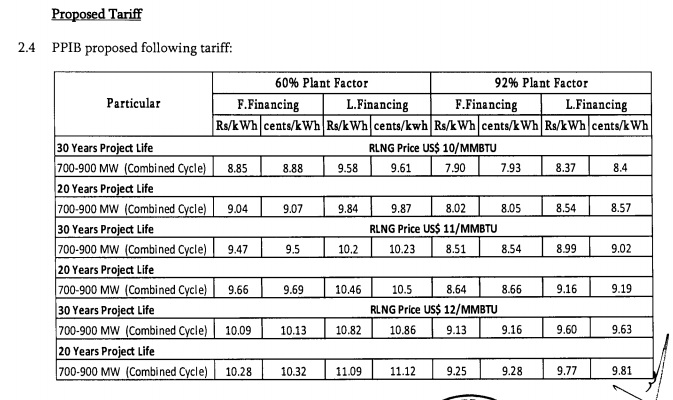

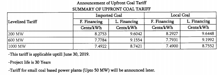

i am simply quoting prices that matter..i.e prices offered by NEPRA.
NEPRA offers 7.8 cents for coal vs around 11.2 cents for LNG
(not final, preliminary at rate of 12 rs LNG which was the price of LNG after all cost of imports and 15% taxes, though later on govt revised the price to around 13rs, so NEPRA is working out the newer price).

remember there other issues rather than mere spot prices in pricing LNG, prices varies at different areas its not simple, i also dont know whom prices are you quoting here. also return rates on power plants matters
The documents say that the tarrif rates are dependent upon
1-Plant size
2-Source of Financing
3-Plant Factor or efficiency
4-Source of Fuel
5-Price of Fuel

ok let me correct my self for 900mw plant 20 years 60% plant factor its from its from 10.32-11.12 cents.
sorry for just quoting 11.12 cents in my original post(this is for local financing, 60% plant factor, the most common case)
If you had read all document you would have known that price of 12MTBU is also not expected by NEPRA.
it thinks that price will go up. the recent LNG shipment was at 12$, even though the cost for LNG is around 9$ , we have to pay 90 cents for terminal, another 90 cents for transport and 15 % taxes in addition to gas utility and transport charges.
in short even if oil prices dont go up, which it will eventually the price of coal will be cheaper.
even if oil prices go down , coal will be adjusted to go down too.
with affordibility the main problem and high natural gas mix(nearly 60%) we need to focus on coal rather than LNG power plants
