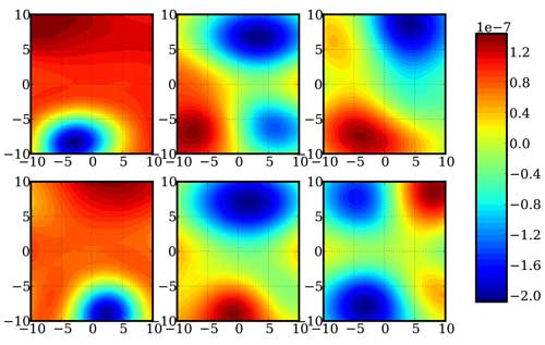

A depiction of a random two-dimensional slices of a 12-dimensional function for determining energy and frequency corrections of a formaldehyde molecule. (Image: Sandia National Laboratories) (click on image to enlarge)
