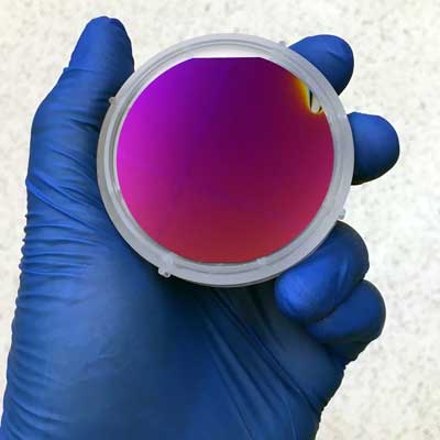

Researchers at Purdue University created this 2-inch silicon wafer coated with thin films of tantalum and silicon nitride for enhanced solar absorption. The solar absorber was designed for use in “concentrated solar power” plants that might run up to 24 hours a day. (Image: Zhiguang Zhou)
“In this study, we use off-the-shelf silicon wafers as a platform to design, fabricate, and characterize a structure capable of absorbing lots of sunlight, without re-radiating as much heat,” he said. “We add a layer on the top and bottom to give it greater ability to absorb sunlight, while also reflecting longer wavelengths.”
