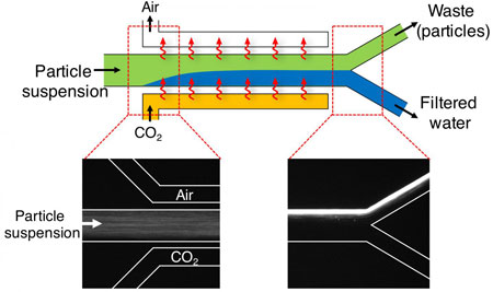

The system injects CO2 gas into a stream of water as a method of filtering out particles. The gas, which mixes with the water in a system of channels, temporarily changes the water's chemistry. The chemical changes cause the contaminating particles to move to one side of the channel depending on their electrical charge. By taking advantage of this migration, the researchers are able to split the water stream and filter out suspended particles.
Carbon dioxide changes the chemistry of contaminated water, which causes particles to move to one side of a channel and splitting the flow into clean and dirty streams. (Image: Howard Stone Lab)
