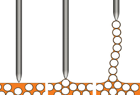

Particles are pulled out of a dispersion to form a chain, by applying an electric field through an electrode.

Rozynek and Han performed multiple calculations, showing how the electrode's electric field changed the particles' properties. When the electrode is dipped into the colloidal solution, its charged tip polarizes each sphere. These induced dipolar interactions cause the spheres to link together. A resulting chain could contain hundreds of thousands of spheres, reaching up to 30 centimeters in length.
After the team solved the mystery of how the chains formed, it had a second mystery to tackle. "Another fascinating part is that once we pulled the chain out of the liquid, we no longer had to apply an electric field to hold the chain's structure," Han said. "After the field was turned off, the stable particle chain remained stable."
Following months of investigation, Luijten and Rozynek's teams discovered that the chains maintained their structures due to liquid "bridges" between adjacent particles. As researchers pulled the chain out of the liquid, silicone oil clung to the sides of each particle, forming a case around the entire chain and keeping it intact.
"Surface tension plays a big role here," Han said. "The liquid bridge made the particles stick together. The physics here is really interesting. Most people would think that if you wanted to hold the structure, then you would need to apply the electric field. But that is not needed in our system."

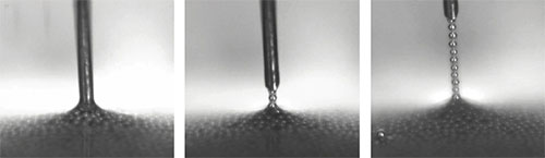

When the electrode is raised, a conductive chain is pulled out of the dispersion.
Once the flexible chain is pulled out of the liquid, it can be immediately dragged along a surface and deposited to create a pattern. The researchers believe this method could be used as an alternative way to create simple, two-dimensional electronic circuits. If molten wax is used instead of silicone oil, then the method could also be used to build three-dimensional structures that hold their shapes when the wax cools and hardens.
