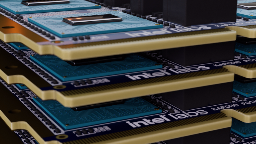

Kapoho Point (which, like all of Intel’s neuromorphic releases thus far, is named after Hawaii’s volcanic geography) marks a new form factor for Intel: an ultracompact board about three inches square (Davies likened it to a credit card) with four Loihi 2 chips on its top side and another four on its underside, for a total of eight Loihi 2 chips at “the most minimal scale possible.”
Kapoho Point. Image courtesy of Intel.
Davies said that Kapoho Point can represent “up to a million neurons” and “up to a billion synapses” — “a pretty good scale of network size just in this very compact form factor.” It can solve optimization problems (an area of particular strength for neuromorphic computing) with up to 8 million variables and, according to Intel, with up to 1000× better energy efficiency than a state-of-the-art CPU solver.
“Another property you’ll see in this diagram about Kapoho Point is that it’s stackable,” Davies said. “You can just layer these on through this expansion port you see on the board there and build out to a larger capability. We’ve assembled stacks as [high] as four boards here that get up to 32 million neurons, which is quite a reasonable scale, especially if you think about optimization problems.” Davies said that Intel expected Kapoho Point to be stackable up to eight boards before other form factors would become more desirable solutions.
Stacked Kapoho Point boards. Image courtesy of Intel.
