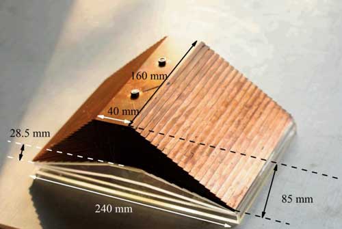

This is a photograph of the fabricated sample. (Image: CAS)

The research team then used layers of brass plates featuring small channels filled with water to construct the model cloak. This material possesses effective anisotropic mass density in long-wavelength regimes.

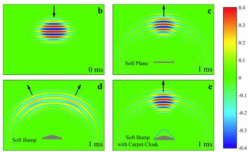

These are numerical simulations of the underwater carpet cloak. (Image: CAS) (click on image to enlarge)
The structure of the carpet cloak, comprised of layered brass plates, is therefore simplified at the cost of some impedance match. "The carpet cloak has a unit cell size of about 1/40 of the wavelength, making it able to control underwater acoustic waves in the deep subwavelength scale," said YANG Jun.
The proposed carpet cloak has shown good performance in experimental results across a wide frequency range. In tests, a short Gaussian pulse propagates towards a target bump covered with the carpet cloak; the scattered wave then returns in the backscattering direction. The cloaked object successfully mimics the reflecting plane and is imperceptible to sound detection.
