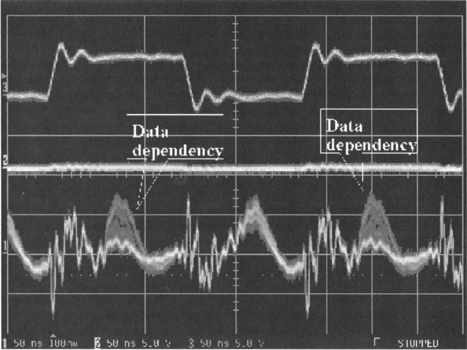

Different instructions have quite different power-consumption profiles, and, as you can see in the figure, the power consumption also depends on the data being processed. The main data-dependent contribution in many circumstances is from the bus driver transistors, which are quite large (see the top of Figure 14.5). Depending on the design, the current may vary by several hundred microamps over a period of several hundred nanoseconds for each bit of the bus whose state is changed [547]. Thus, the Hamming weight of the difference between each data byte and the preceding byte on the bus (the transition count) is available to an attacker. In some devices, the Hamming weight of each data byte is available, too [549]. EEPROM reads and writes can give even more substantial signals.
The effect of this leakage is that an attacker who understands how a cipher is implemented (for example, as a result of probing out the card software and disassembling it) can obtain significant information about the card’s secrets and, in many cases, deduce the value of the key in use. It is particularly significant because it is a noninvasive attack, and can be carried out by suitably modified terminal equipment on a smartcard carried by an unsuspecting customer. This means that once the attacker has taken the trouble to dismantle a card, understand its contents, and design the attack, a very large number of cards may be compromised at little marginal cost.
Figure 15.1 Superimposed power consumption traces of a Siemens SLE44 smartcard, showing data dependency (courtesy of Andy Santoso). The upper half of the screen shows the clock signal; the lower shows the power consumption.

The attacker first collects a number of curves (typically several hundred) by performing known transactions with the target card—transactions for which the encryption algorithm and either the plaintext or the ciphertext is known. She then guesses some of the internal state of the cipher. In the case of DES, each round of the cipher has eight table look-ups in which six bits of the current input is exclusive-or’ed with six bits of key material, and then used to look up a four-bit output from an S-box. So if it’s the ciphertext to which the attacker has access, she will guess the six input bits to an S-box in the last round. The power curves are then sorted into two sets based on this guess and synchronized. Average curves are then computed and compared. The difference between the two average curves is called a differential trace.
The process is repeated for each of the 64 possible six-bit inputs to the target S-box. It is generally found that the correct input value—which separates the power curves into two sets each with a different S-box output value—will result in a differential trace with a noticeable peak. Wrong guesses of input values, however, generally result in randomly sorted curves and thus in a differential trace that looks like random noise.
In this way, the six keybits which go to the S-box in question can be found, followed by the others used in the last round of the cipher. In the case of DES, this gives 48 of the 56 keybits, and the remainder can be found trivially by exhaustive search. If the cipher has many more keybits, then the attacker can unroll it a round at a time.
