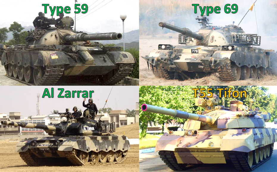

The picture shows easiest difference for identifying a T-59 from T-69; placement of the headlights.
T-59 has one headlight placed on hull above Glacis.
T-69 has two headlights placed on hull, above side skirts, on both sides of glacis.
