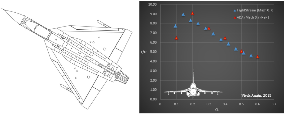

The realm of computational fluid dynamics
Evaluating aircraft aerodynamic performance using Computational Fluid Dynamics (CFD) methods is inherently time and resource intensive. As such, it remains the domain of large corporations and governmental agencies. However, such a detailed analysis is hardly required to determine aircraft performance. For an aircraft such as the LCA, suitable aerodynamic performance can be evaluated using surface-vorticity solvers such as FlightStream, developed by the Research in Flight Company (found here). The Author developed this software years ago as part of his academic research work and has applied this software to the LCA. In doing so, the primary aerodynamic data such as the force and moment coefficients can be evaluated as a function of angle-of-attack and altitude. The accuracy of FlightStream, for such an analysis, is acceptable only for the range of Mach numbers from low subsonic till the point of local supersonic flow over the wings and from small angles of attack till the point of flow separation over the wings. Working backwards from the available three-view data for the LCA available in the public domain, a surface mesh of the LCA was created using the open-source NASA software OpenVSP (found here). FlightStream has direct connectivity with OpenVSP and the surface mesh solution is evaluated for vorticity. The vorticity data is then used by the solver to generate aerodynamic loads data. Using this approach, the author was able to get reasonably close to the wind-tunnel data evaluated by the Aeronautical Development Agency (ADA) as shown below for the force coefficient matrix.
![](/proxy.php?image=http%3A%2F%2F1.bp.blogspot.com%2F-kGIW91ejy4I%2FVSnRhOTQ3fI%2FAAAAAAAABF0%2FC9B77lmTnJ4%2Fs1600%2FLCA_02.png&hash=872cf133510be7e163117e5e764534e4)
The force-coefficient matrix is plugged with a first-order propulsion module to simulate engine performance as a function of local atmospherics and altitude. The data generated by these routines are combined with the known mass properties of the aircraft to generate range and payload data which is then presented below for analysis. The said analysis is simplified to allow the reader to grasp the essentials of the performance results for the LCA.

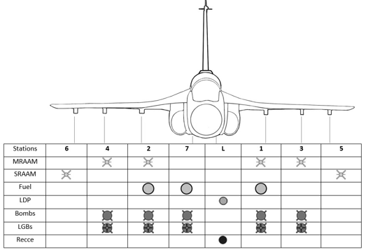

Assumptions that went into the analysis include the empty weight of the LCA as being 6,500 Kg. The engine used was General Electric F404-GE-IN20 with a rated output of ~54 kN and a rated TSFC of ~0.77 lbm/lbf-Hr. The internal fuel capacity of the LCA is assumed to be 3,034 Liters and the aircraft is assumed to be capable of carrying a centerline external drop tank of 725 Liters as well as one 1,200 Liter drop tanks on pylon stations 1 and 2, respectively. The cruise speed of the LCA is evaluated for maximum range for each condition.

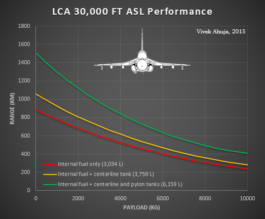

The performance of LCA are summarized in the form of payload and range plots. The payload is evaluated from 0 to 10,000 kg and is assumed to include the pilot weight and all auxiliary equipment excluding fuel. The vertical axis of the plots is range, measured in kilometers. The combat-radius of the aircraft is considered to be ~40% of the range. For example, a range of 1,000 km corresponds to a combat radius of ~400 km. Plots are provided for the LCA in three conditions: clean (internal fuel only), combat (internal + centerline drop tank) and ferry (internal + centerline drop tank + 2 x wing drop tanks). Additionally, three altitude conditions are provided: sea-level, 20,000 ft above-sea-level (ASL) and 30,000 ft ASL.
![](/proxy.php?image=http%3A%2F%2F4.bp.blogspot.com%2F-4yOjn_-nAnY%2FVSroAvGSy4I%2FAAAAAAAABG4%2FEeqhb48UQrk%2Fs1600%2FLCA_04.png&hash=fe7263a8f8ffd94413c3049aefcf9132)
![](/proxy.php?image=http%3A%2F%2F1.bp.blogspot.com%2F-mAYtyHpTXJw%2FVSroAsraQ2I%2FAAAAAAAABG8%2FjnWJcDjzfts%2Fs1600%2FLCA_05.png&hash=d5fca6918fb1607044c127a01b35977c)
![](/proxy.php?image=http%3A%2F%2F3.bp.blogspot.com%2F-Df4trvsiYvU%2FVSroApsYZzI%2FAAAAAAAABG0%2FBbVz-nxKPj4%2Fs1600%2FLCA_06.png&hash=64d99c586ec397703c4c4ed85ec1be6a)
It is very clear that the design of the LCA allows for a dynamic performance matrix. In the ferry condition, flying at 20,000 feet ASL, the LCA can self-deploy to locations over 1,600 km away when carrying no payload. Carrying a light 1,000 kg payload, the LCA can ferry itself at high altitude to locations over 1,400 km away. Reviewing the altitude conditions suggest that there is an optimum high-altitude endurance regime for the LCA beyond which the benefits of altitude begin to wear off (as shown in the results for the 30,000 ft ASL plot above).
