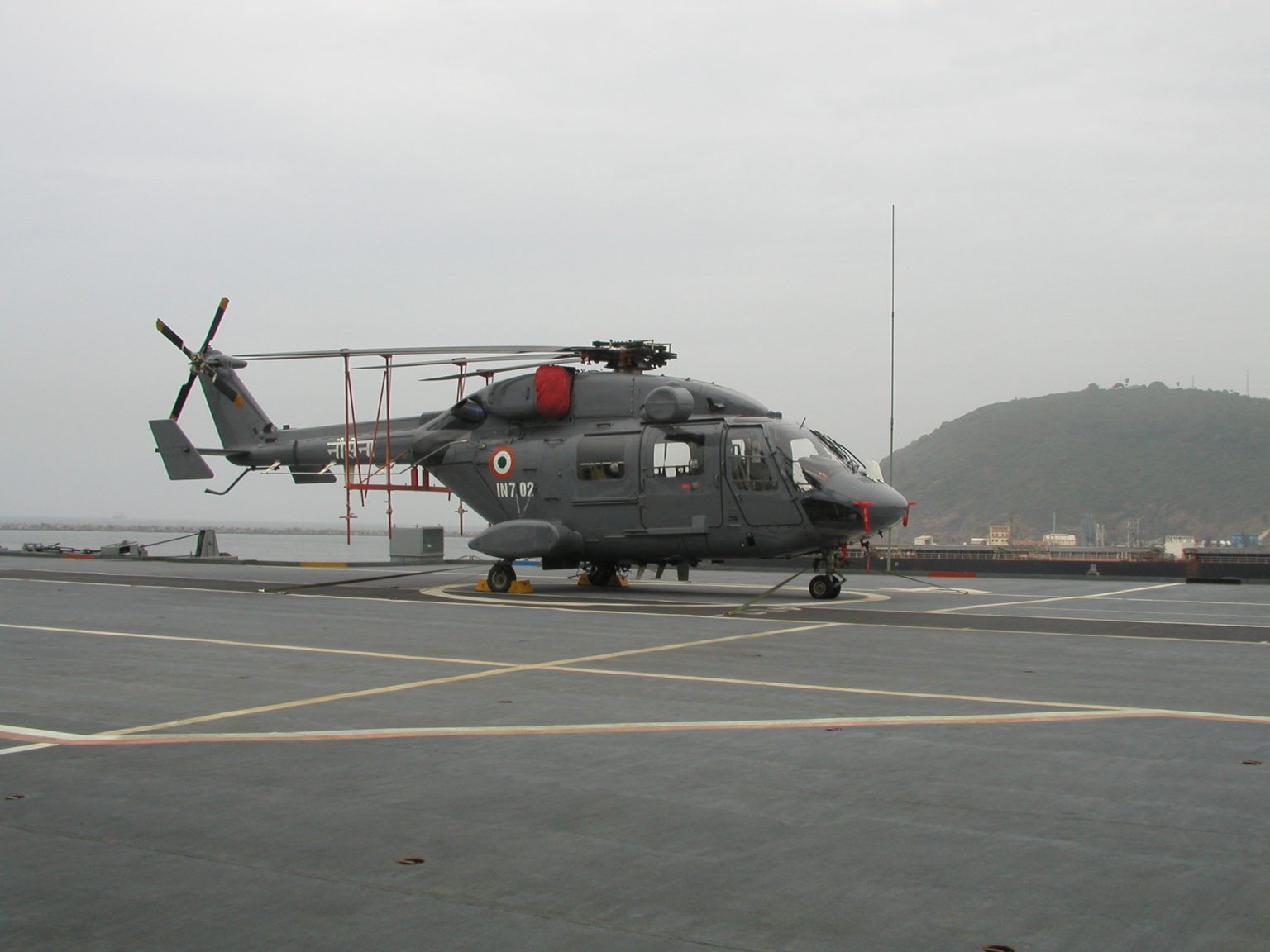

Blade folding is a major sticking point that is currently being discussed. The navy had specified to HAL the requirement of a 3.5 m blade-folded width right from the very start. This was based on the shipborne requirements because, after all, the helicopter would have to land on a ship and be stowed in the hangar after folding the blades. At sea the requirement is also for a quick and easy way of folding the blades. Just like the Chetak or the Kamov, or the Sea King. Logically then, HAL should have thought about this as a major design shortcoming before even offering a helicopter with any width greater than 3.5 m. The navy had contributed a fair amount of money towards the development of the indigenous helicopter, yet it is quite clear that the blade folding requirement was not given its importance even during basic design at HAL. The navy as usual was forced to accept the initial lot of helicopters under concession.
It is always the crew that are pressurised to support ‘indigenous effort’ and were as usual told to at least start flying the helicopter and gain some experience. This was for the first 8 helicopters. Today, this very acceptance of a concession is being turned around to twist the Navy’s tail by making statements like the navy and HAL should sit together to discuss these points and engage HAL to let them know what the navy wants.
As a solution about fifteen years back, HAL had made the suggestion that the Navy should accept the method where one blade remains forward and other three go back. For this, HAL actually suggested that the Navy should cut holes in the helicopter hangar for the front facing blade – classic case of making the hand fit the glove. The thing is, these suggestions are often made at the MoD level, and the impression given is that the Navy is adamant in not taking this option. Similarly, the concession given to HAL was to achieve a 5.4 m folded width to begin with, instead of 3.5 m. They could not meet even this 5.4 m, and the constant complaint in any forum was that navy cannot accept even 0.2 m more than the required width – conveniently forgetting that the 0.2 m was from the 5.4 m, not the original requirement of 3.5m.
The problem in all this is that the person on the top does not have the background and the time to understand the nuances and gets convinced that the navy is putting unreasonable demands. The segmented blade folding option was discussed way back in 2005-06, so there is no reason that HAL should not already have done this over the last fifteen years if they were serious. At that time HAL had wanted the Navy to sponsor the study and trials. There is nothing new in segmented blade folding. The Chetak has got a two-piece blade from 1960 onward. Retrofitting the ALH for segmented blade folding will not only increase weight, but should also involve hundreds of hours of testing. And I’m not sure whether to trust the results of these flight tests, given the efficacy of the rigorous testing that HAL does.
To give everyone a clear viewpoint of the blade folding procedure, there were a total of 64 loose items that had to be removed, used, fitted back at the time the kit was offered in 2005. This took over half an hour, though a timing of 22 minutes or so was demonstrated using five HAL personnel and safely on ground with no wind and no rolling and pitching of the deck. I can’t imagine five personnel being employed for folding the blade in a procedure that takes over 20 minutes. During folding on board the carrier the first helicopter became unserviceable because the lining on the blade came off as soon as we folded and put back the blades. On the second aircraft, the bolt broke. HAL will claim that they have rectified this, by putting the lining on the bolt and using a better material of the bolt. They also would have reduced the number of items. But the procedure still takes too long, and at sea, this becomes a danger from submarines to the ship which has to maintain a steady course.
