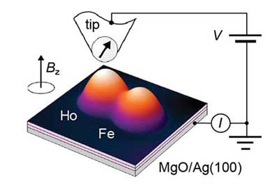

A holmium (Ho) and a iron (Fe) atom placed on a MgO substrate are the components for the world's smallest memory device. Ho is used as a storage medium and Fe as a sensor were. The magnetism of the holmium atom can be changed or read by flowing current through the STM tip.

In this study, scientists worked with a tool, called Scanning Tunneling Microscope (STM), which has a special tip that enables the user to view and move individual atoms, as well as to apply a pulse of electrical current to them. They used this electric pulse to change the direction of magnetization of individual holmium atoms. By doing that, the team could write a memory of either 1 or 0 in a single holmium atom as well as swap the two.
A quantum sensor, designed by Heinrich’s team and currently unique worldwide, was used to read the memory stored in the holium atom. It consists of an iron atom placed next to the holmium atom. Using this technique, as well as another one, called tunnel magnetoresistance, the researchers could observe that holmium maintains the same magnetic state stably over several hours.
