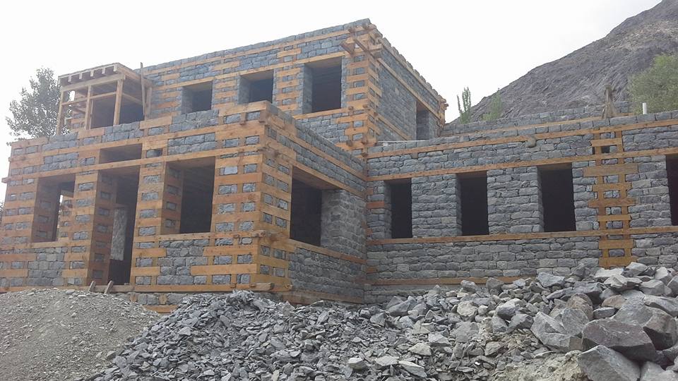

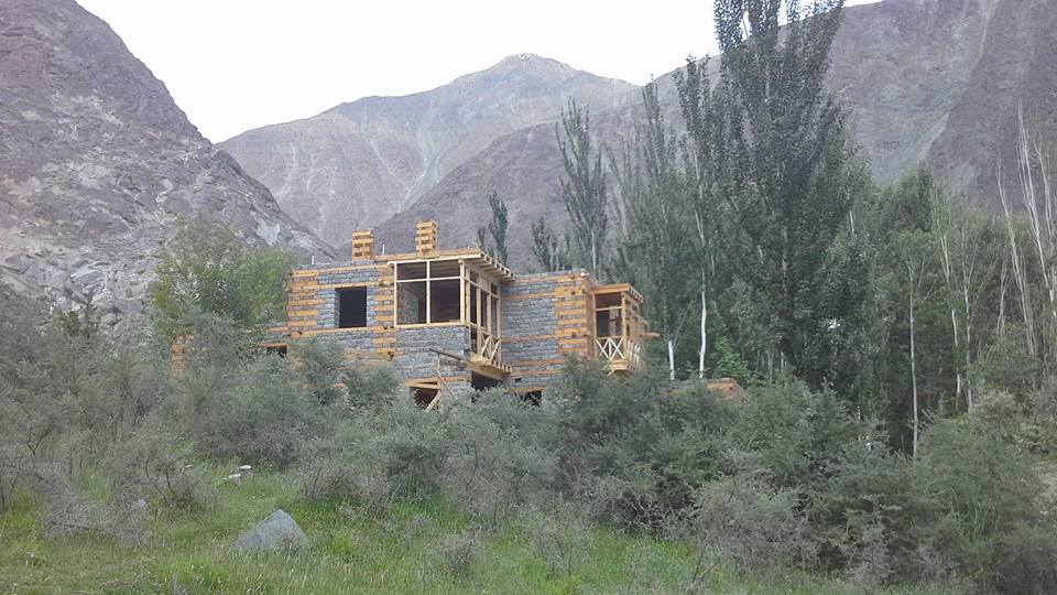

I think i should also add the fact that these houses are one of the most earthquake resistant buildings designed. Recently i have seen many houses in gilgit baltistan made of cement and just within one or two years huge cracks have been developed in the walls also it is extremely hot in summer and extremely cold in winter in these cement made houses.these houses are also very volatile to the climatic hazards in our areas.

Recently there has been development in the plannig and construction of these traditional houses to direct people into constucting them rather of cement building the have been modrenized to a large extent the work mostly done by Aga Khan culture service Pakistan to mainstream traditional houses
such as this model house
