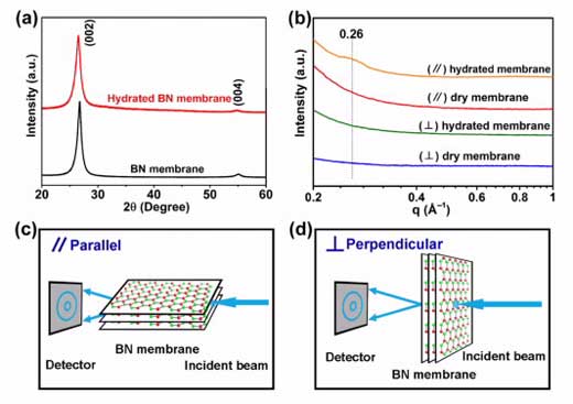

Measurements at the Australian Synchrotron at the SAXS beamline allowed them to determine the average spacing between the layers.
a) XRD patterns of a dry BN membrane and a fully hydrated BN membrane, with (002) and (004) diffraction peaks at 26.7° and 54.9°,respectively. (b) One-dimensional (1D) SAXS patterns of dry and fully hydrated BN membranes aligned perpendicular and parallel to the X-ray beam, patterns stacked by offset from the intensity scale. (c, d) Schematics showing the parallel (c) and perpendicular (d) position of the BN membrane in the SAXS analysis. (Image: ANSTO)
“The X-ray beam, which is about 200-300 microns in diameter, is well suited for analysing a many nanolayers, giving a statistical perspective on structure,“ said Garvey.
