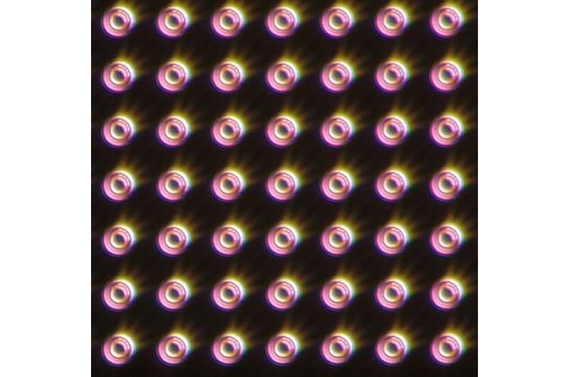

SFU researchers find the missing photonic link to enable an all-silicon quantum internet
An optical microscope image of an array of integrated photonic devices, used to perform the first all-optical single-spin measurement in silicon. Tens of thousands of such ‘micropuck’ devices were fabricated on a single silicon photonic chip. Credit: Photonic
"With T centers, you can build quantum processors that inherently communicate with other processors," Simmons says. "When your silicon qubit can communicate by emitting photons (light) in the same band used in data centers and fiber networks, you get these same benefits for connecting the millions of qubits needed for quantum computing."
