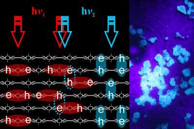

The way of how the light with different wavelengths influences on a MOF crystal: different types of excitons are showed in red and blue (left). Image of crystals (right). (Image: ITMO University)

In such crystals, the researchers learned to bring two types of excitons individually: intralayer and interlayer. The first arise when a photon absorbed by the crystal turns into an electron-hole pair inside a layer, but the second appear when an electron and a hole belong to neighboring layers. In some time, both kinds of quasiparticles disintegrate, re-radiating the energy as a photon. But excitons can move around the crystal while they exist.
