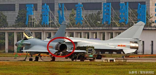

J-10C used WS-10x domestic made high thrust engine instead of many assume AL-31FN russian engine. Mine assumption of J-10C enter service with high thrust domestic engine is correct.

Buta again. This image you used show thal last two batch 01 aircrafts, none of any operational j-10 uses so far a WS-10 ... Snd you are mixing again J-10A, AY and B all with AL-31 nozzles.
