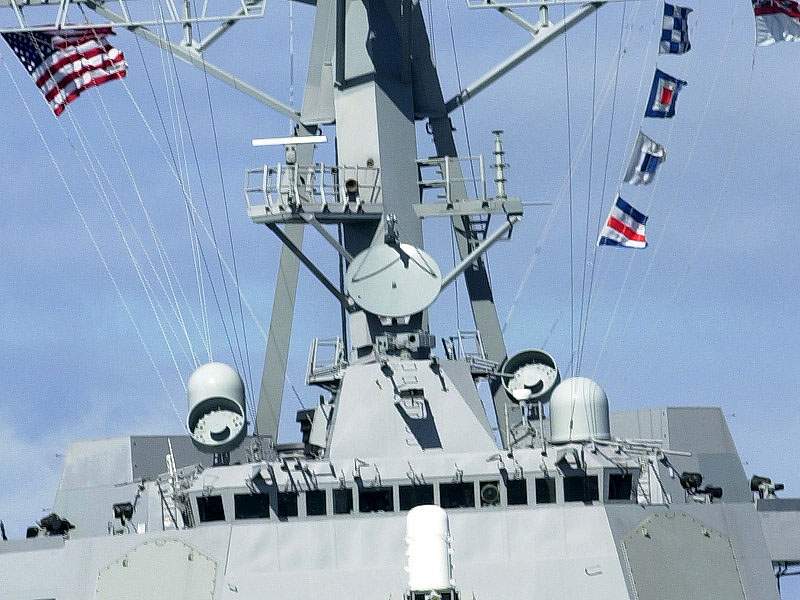

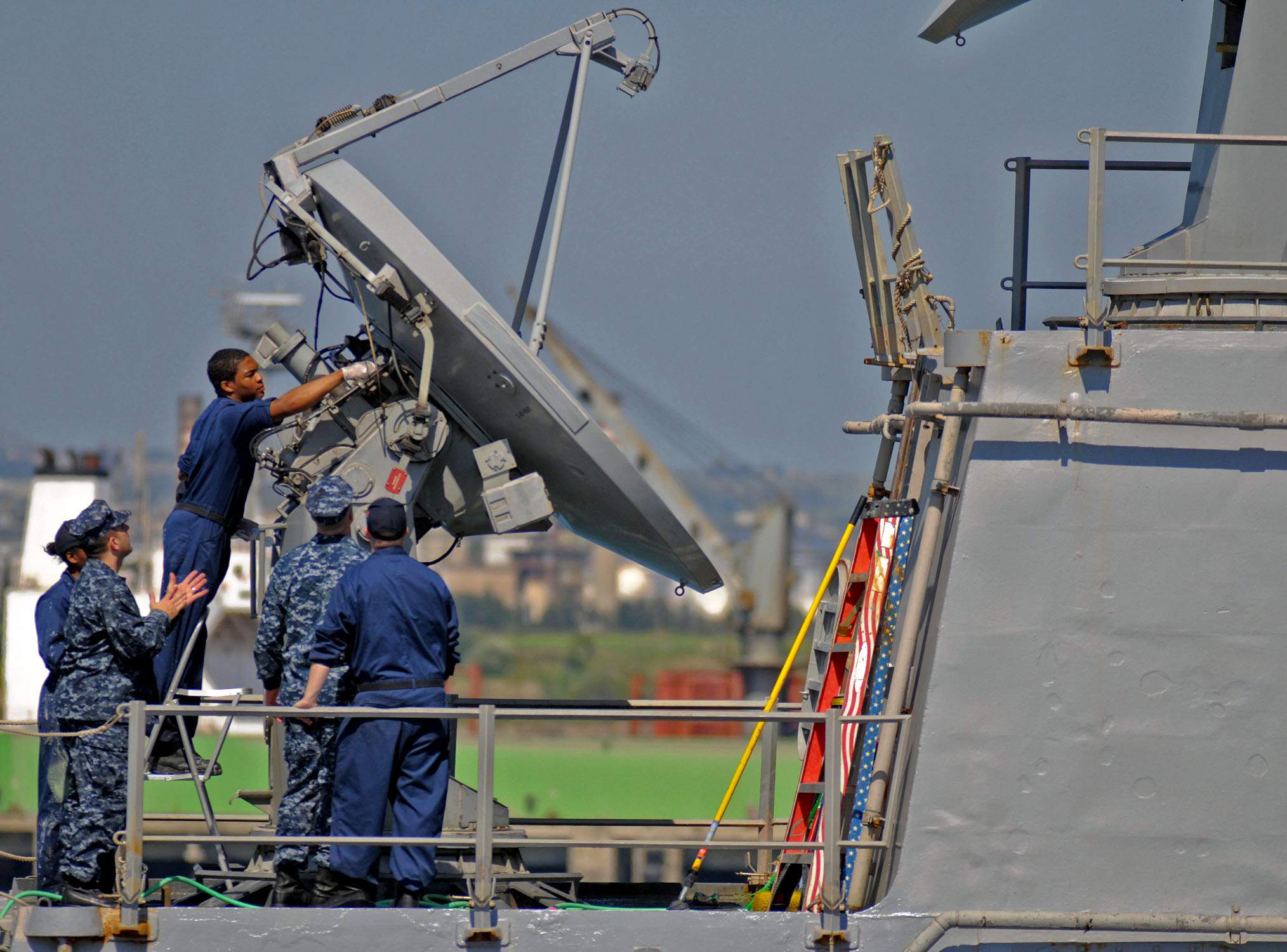

However, look for these and you'll find your answer;
This is an SPG-62 on DDG-55 Stout.
This is on DDG-81 Churchill.
@Carlosa - there's one covering all "necessary" areas.
@Carlosa - there's on covering all "necessary" areas.
