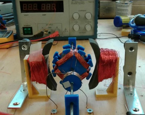

Ellery said he and his colleagues are close to being able to 3D-print a fully functioning electric motor from material similar to what can be sourced on the moon. Although some commercially available 3D printers can reprint some of their own parts, none of those printers can produce motors and electronics, according to Ellery.
"Our starting point is the RepRap 3D printer, which can print many of its own plastic parts," Ellery told Space.com, referring to the open-source device originally developed by the University of Bath in the United Kingdom. "In order to fully self-replicate itself, it needs to print its metal bars, its electric motors, its electronics and software, and self-assemble."
Ellery and his team, who described the project in an article published in the Journal of Spacecraft and Rockets last year, are using a mixture of a plastic material and iron filings to 3D-print two parts of the motor, the stator and the rotor.
"We need to maximize magnetic threading through the rotor, which requires more iron, but minimize eddy currents in the stator, which requires less iron," Ellery said. "So we have been varying the amount of iron in the plastic matrix."

As a next step toward 3D-printing the motor, the researchers are aiming to replace the motor's wire coils with aluminum coils printed onto a polylactic acid plastic substrate (the latter is a common material used for 3D printing). On the moon, the aluminum would be replaced with fernico (iron-nickel-cobalt alloy) and the plastic would be replaced with a ceramic substrate made from melted lunar soil.
The magnetic field produced by the aluminum coils printed on the plastic substrate is "actually quite weak, so we are trying figure out ways to add more layers to increase the amount of current that goes through them," Ellery said. "But eventually, what we will do is that we will integrate that into the motor so that will give us a complete core, which is 3D-printed."

This small motor was made using some 3D-printed parts. Researchers at Carleton University are working to make the entire motor 3D-printable. Credit: Alex Ellery via GIPHY
