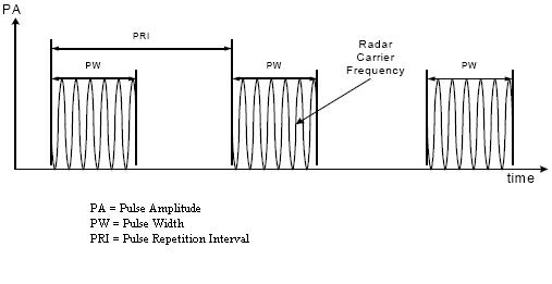

The above is an illustration of a bare bones basic radar pulse. This is as basic and simple as you can get to a functional signal.
Each pulse have two time stamps of/from: leading edge and trailing edge.
It is from these time stamps that we use to calculate these vital target resolutions:
- Altitude
- Speed
- Heading
- Aspect angle
Because of these two time stamps, each pulse have a characteristic call 'finite pulse length'. Or to put it another way, each pulse is a finite packet of energy.
The above illustration also shows a 'pulse train'. We see three pulses in regular spacing of each other. That is the pulse repetition interval (PRI). The PRI must be measured from either leading edge to leading edge, or from trailing edge to trailing edge. Never from leading to trailing.

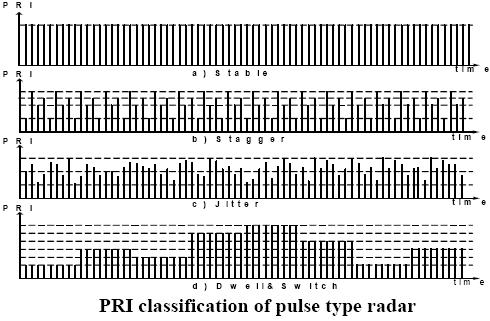

So for military purposes, how can we make it more difficult for the opposition to employ countermeasures ? We alter the characteristics of the pulse train.
For the above illustration, we have modification of only the PRI.
The first two -- stable and stagger -- predictable. Any countermeasure tactic using DRFM can easily remember this pulse train and create an interference signal. The resources used for this will be minimal.
The last two -- jitter and dwell/switch -- can be as unpredictable as the seeking radar is designed for. The resource require for these two tactics will be much greater than stable and stagger. The seeking radar must remember each pulse train's characteristics to recognize the echo signals, which should have the same characteristics.
