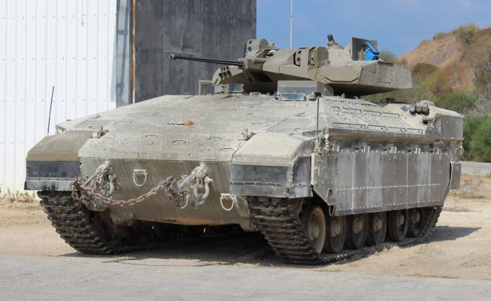

IMOD's Tank Program Administration (MANTAK), together with the IDF Ground Arm, has recently begun the first series of tests on the Namer armored personnel carrier (APC), equipped with a 30mm turret. The turret was developed in order to be installed on two of the Tank Program Administration's APCs, namely the Namer and the IDF's first wheeled APC – the "Eitan," which is currently undergoing tests.
"The APC equipped with the gun turret provides a better response to urban combat," said Brig. Gen. Baruch Matzliah, Head of the Tank Program Administration. "The 30mm turret is designed to provide significant firepower to infantry units, to allow fighters to be more independent on the battlefield, and to reduce dependence on assistance from other units.
"The turret is unmanned and does not penetrate the combat cell so that the ability to carry the soldiers is not harmed. Its operation is expected to be simple and will be performed by the APC's crew. The turret will also incorporate an active defense system and additional systems that will greatly contribute to its capabilities."

The turret is not an off-the-shelf design, but dedicated for the needs of the Israeli ground army.

Namer with Samson 30 Mk 1 turret by RAFAEL

It's very clear that this turret is not like anything I've seen before, because it has a very distinct feature of having a turret-mounted APS, not as applique but integrated into it.
Work was not finalized on it, and it may see some additions in the future in the form of an RWS and ATGM launcher.

1)It is equipped with a powerful array of optics. Elbit has a long record of supplying top of the line FCS (Fire Control System) and optics to the IDF through its subsidiary El-Op, who won its first Israel Defense Prize in 1997 for creating the Baz FCS for the Merkava 3 tank.
Elbit's COAPS sight, same as the one used on Singapore's Leopard 2 EVO tanks. It appears the gunner's sight is a static version of the COAPS.
2)Geared with Trophy HV Active Protection System, similar to the one fielded on Merkava 4M tanks and Namer CEV. The difference between this one and the CEV which already rolls with a Trophy system, is that this one is turret-mounted, and does it as an integrated system rather than applique.
Certain applications of APS on existing vehicles require mounting the APS on the hull, as it would otherwise be impossible on the turret without reaching tremendous costs, or breaching the upper limit of capabilities of the turret systems.
An APS is an immensely valuable asset on every vehicle, and is currently revolutionizing ground combat vehicles in multiple countries such as the US's MAPS effort which currently seeks an off-the-shelf system before going into a self-developed one, and Russia's Afghanit.

4)Something rather unexpected that caught my eye was the mortar. Yep, the iconic Merkava's feature of having a 60mm light mortar in its roof was copied into the new turret. That definitely testifies on what its operators and MANTAK as a whole think of the mortar's contributions throughout its very long service. It lays smoke at day, illuminates at night, marks targets with colored smoke, or fires HE on concealed targets to avoid exposing the vehicle. What is there not to love?
I believe it's not just a lovely gesture, but some original thinking. And although not new, it adds a new level of support the Namer can provide to its infantry. It could lay smoke for them, serve as artillery pocket for them, or the commander could even mark specific targets for them if they're not currently watching the BMS or have difficulty with precision spotting.
