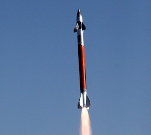

At less than 1 meter long, less than 50 millimeters in diameter and less than 3 kilograms mass at launch, the MHTK is extremely compact and very agile in flight. Photo: Lockheed martin

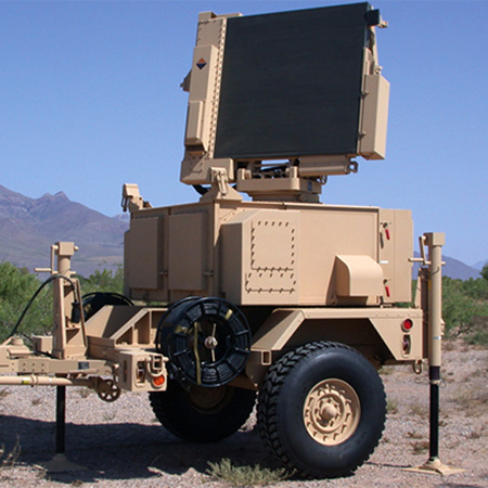

Sentinel is a mobile, tactical air defense and weapon coordination X-band radar that detects helicopters, high-speed attack aircraft, cruise missiles and UAVs. Photo: ThalesRaytheonSystems
Sensors, Command and Control
MML is built on open architecture and will have the capacity to launch a variety of interceptors to provide 360-degree protection against simultaneous threats from rockets, artillery, mortars, precision guided ordnance, cruise missiles and unmanned aircraft systems. IFPS will become part of the Army Integrated Air and Missile Defense (IMAD) Battle Command System (BCS) which also follows open-system architecture. IMAD will be able to allocate target data through the Engagement Operations Cell which links to Sentinel target acquisition radars, acting as the integral fire control sensor for IFPS.
The Improved Sentinel (AN/MPQ-64F1) is a 3D phased array tactical air defense radar developed by ThalesRaytheon Systems. It automatically detects, tracks, identifies, classifies and reports airborne threats. It detects helicopters, high-speed attack aircraft and cruise missiles over 360°. IFPC Inc. 2-I will fund the software upgrades to support the current Sentinel’s counter UAS and CM mission.
More than 200 systems have been ordered worldwide, with more than 100 delivered or in production. Future enhancements currently in development include an 80 percent increase in the radar’s detection range.

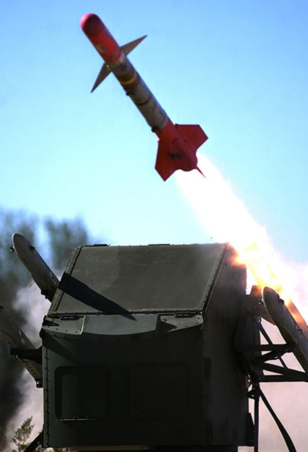

Raytheon’s AI3 uses a remanufactured Sidewinder body fitted with semi-active RF seeker. An improved version of this seeker was recently used to demonstrate an interception of a cruise-missile. Photo:Raytheon
Testing the Interceptors
For the C-RAM interceptor the Army evaluated two different approaches – a brand new Miniature ‘Hit To Kill’ (MHTK) interceptor, developed by Lockheed Martinand a weapon based on remanufactured Sidewinder missiles developed by Raytheonunder the Accelerated Improved Interceptor Initiative (AI3). According to Lockheed Martin, The MHTK guided missile is about 675mm (27 inches) long, 40mm (1.6 inches) in diameter and weighs just 2.26kg (5 pounds). It is expected to cost below $16K.Raytheon did not publish cost estimates for its weapon. Both weapons were tested in 2012-2014 demonstrating their C-RAMcapability against representative targets.
In the Summer of 2014 the AI-3 weapon conducted an intercept of a cruise missile, during the annual ‘Black Dart 2014 demonstration’. The missile used a new semi-active seeker and radar to acquire and intercept the target flying low over the sea in a high clutter marine environment.
Few months later the Army found that the latest AIM-9X with its passive imaging-infra-red seeker would best address the unmanned aerial systems (UAS) and cruise missile threats. This has lead to the use of the Sidewinder in the current test. “The AIM-9X is primarily an air-to-air missile, but it has potential latent capability, and we’re using it here in a surface-to-air capacity. Additionally, this is the first time we’ve ever tried to launch it out of a tube,” said Lt. Cmdr. Robert Betts, US Navy AIM-9X Block II Integrated Product Team lead at PMA-259 China Lake that supported the test. “The Army needed to prove that the tube is reusable and that it could withstand the missile fly-out; making sure the missile didn’t act as a blowtorch, cutting the tube in half on the way out.”

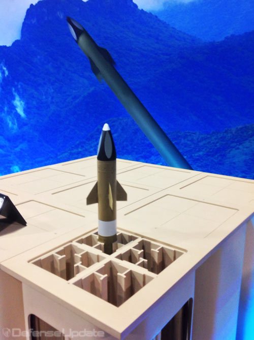

As a miniature weapon, MHTK can quadruple the loadout, enabling each MML to load 60 interceptors. Photo: Defense-Update

The main advantage of MHTK, besides its low cost, is the larger Load out it offers for each MML. With four MHTK missiles integrated into each tube, the system can hold 15 tubes – or 60 interceptors – a critical capability in combating saturation attacks, with multiple simultaneous engagements, characteristic of RAM threats. It also allows stacking few larger missiles with dozens of miniature interceptors.
