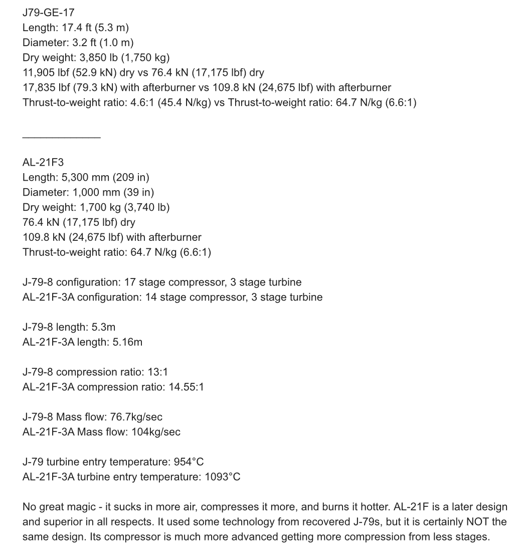

AL-21F-3 is the modified version of J-79 with superior performance in most aspects. Also, hard to find from other markets than Russia. So, may be a plan to work on it!

Turbine inlet temperature of Al21f3 is more than j-79 and it because of kind of Thermal barrier coating, coated on Al2qf3 turbine blade.
So increasing turbine inlet temperature of j-79 convert it to high performance engine.

It is not as easy as you said. All critical components have to be redesigned if more power is needed. Saving in fuel consumption is the only benefit which can be gained with minimum changes. Remember the compression ratios are also different.

Investing on J-79 is nothing but wasting time and resources; while the advanced version of it i.e. AL-21F3 exists in Iran hands, and in fact more needed. Iran purchased around ~ 250 Phantoms with too many spare engines. Currently, only a quarter of the fleet have survived according to many internet resources. So, there should be more than enough spare parts and engines in Iran’s inventory as well as in (even not) black market.

RD-33 is the best path for Iran.
It makes no sense to do the effort for re-engineering the J-79 if it could be done on the RD-33.
Only if Iran got all "blueprints" of the J-79 and prior to it the J-85 producing these engines makes any sense.
The re-engineering step from J-79 to RD-33 is not a big one but the result for the latter is a efficient turbofan used in 2019 5th Gen. demonstrators, while the other is a obsolete fuel thirsty turbojet.
