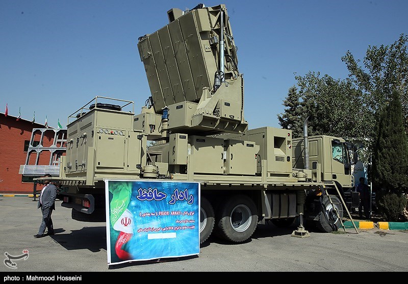

Iran's "Navid" radar was recently showcased during an exhibition visited by Iranian president, Rouhani. The Radar has yet to be unveiled officially so not all specs are known but it is an S-band AESA radar, range speculated to be 400km or more. It is also believed to use Iranian gallium nitride T/R. The radar appears to have characteristics of a counter battery radar and an air defence radar.
It will be used to complement the previous counter battery radar, "Hafez", which was produced few years ago and has a range of 250km (shown below).
This adds Navid to the list of the impressive numbers of Iranian designed radar, alot of which are AESA radars.
